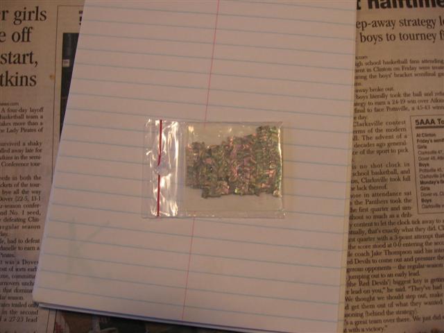

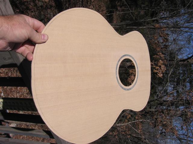

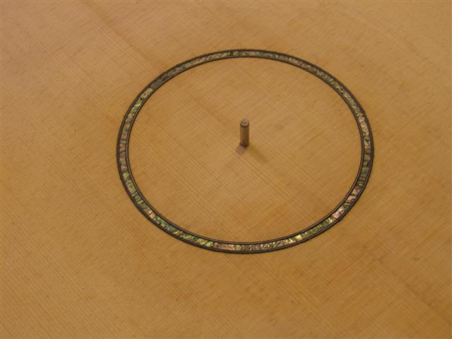

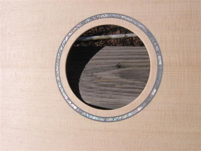

Simple Rosette with Red Abalone 1/8th", installed with bwb French purflings, fiber, and white Titebond. I didn't use teflon, rather I just sweated it out. The two hardest pieces were the last two, had to fight the purfling but I finally won with that big old hammer.

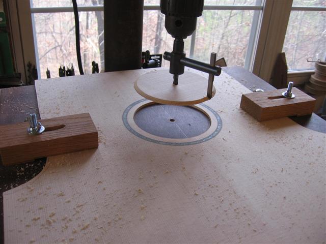

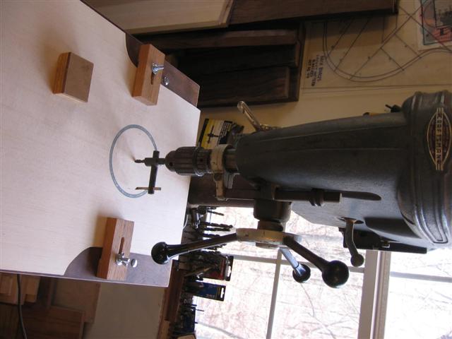

Yeah that little ceramic Dremel wheel is fine for this job. My first took twenty six trips over to the grinder and back. My second I hand held and did this way, by eye. The third, shucks I just made a route on a bad piece of spruce to hold the diameter and made the slot to get the angle pretty close. It's fairly accurate, but also forgiving.
The purfling did have to have one extra splice, but I'm not telling anyone where it is spliced. I think it's good enough to leave totally exposed by the fretboard. Not perfect, but good.

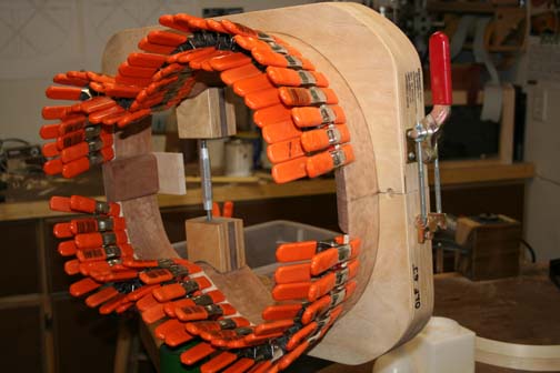

Things have gone well today. I've been crankin' on this.

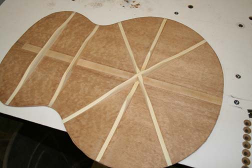

I started out with the back and added the two "star" braces that intersect the X.

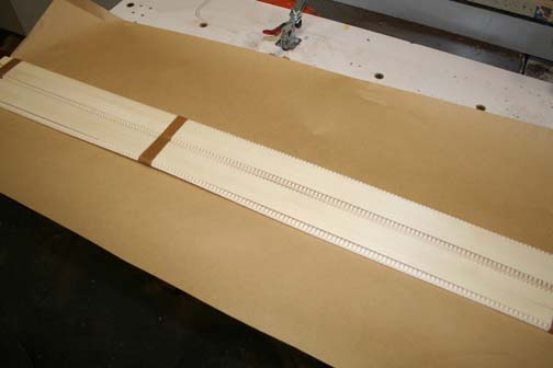

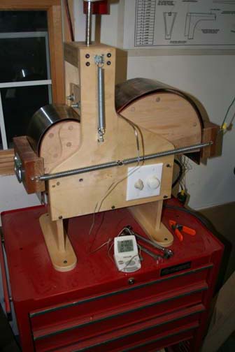

Then I moved on to the rimset. As the lining that Lance sent came to me in 13 pieces, it was suggested that I go ahead and use my linings. (CFox style) So here they are grouped and ready to bend.
Here's how they are bent. ( I know everyone knows this but thought it would be good for the journal).

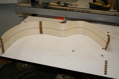

Here are the linings after bending.

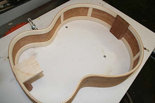

Then the linings are clamped into the rimset. This is a long process as there are 8 pieces that all need to get clamped in.
Then to the grinder to profile the back and top of the rim to accept the guitar's back and top. Here is the completed rimset.

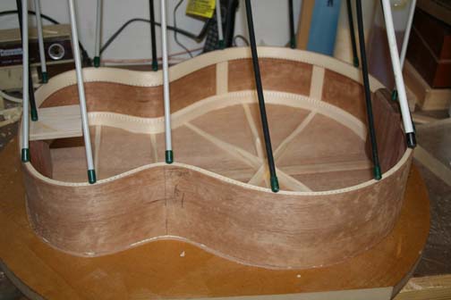

Once profiled, the back is glued on in a raduised dish.
Tomorrow's task is to route the lip off the back, pack it up and ship it of to Bruce.
Thanks for looking. P

Aha, Paul!
I was perusing the pics again and said, "Where's the mold." "There's no mold."
Then it hit me. Those are reverse kerf type two-part linings with a solid inner core. I remember reading about them on CFox Tour by Frank Ford on www.frets.com
You sly dog. You won't be shipping me any mold then will you? It's not needed anymore. Congrats on a superb job. That's a tough rimset once joined. I like your linings as well as anything I've seen. Bruce Dickey38778.994537037
